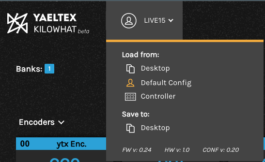

Thanks for the reply. Is there a way to see which firmware I’m running? Looking at the update log, I’m thinking it must be 0.22 given the unit’s purchase date (August 2023). Definitely not running 0.24 since that was just released. Was there a 0.23 along the way?

You can check your firmware version in Kilwhat by connecting your controller and opening the drop-down menu under its name. You can do it when you have time, but it won’t solve the issue.
