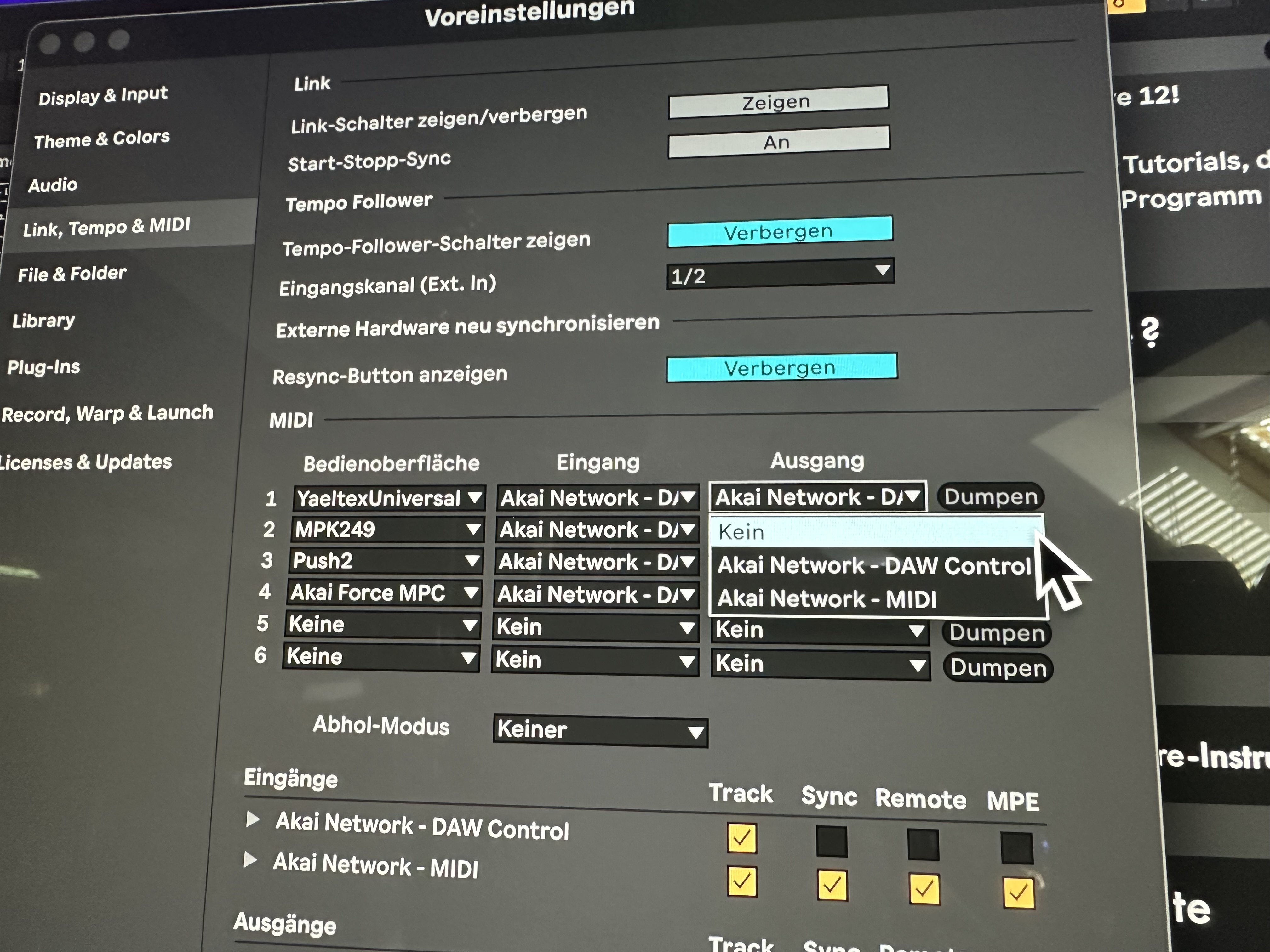

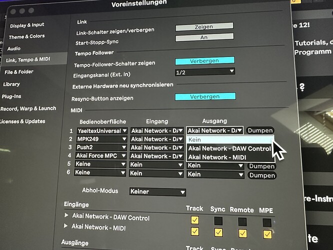

I’ve inserted the MIDI script as described, but I can’t activate it in Ableton’s MIDI input and output! I’m attaching a few photos to demonstrate the problem. Sincerely, jo
Seems like the controller is not being recognized by Ableton or the computer itself. Can you try in any other MIDI applications? You can quicky check it on midimonitor.com as well (from a chromium browser)
