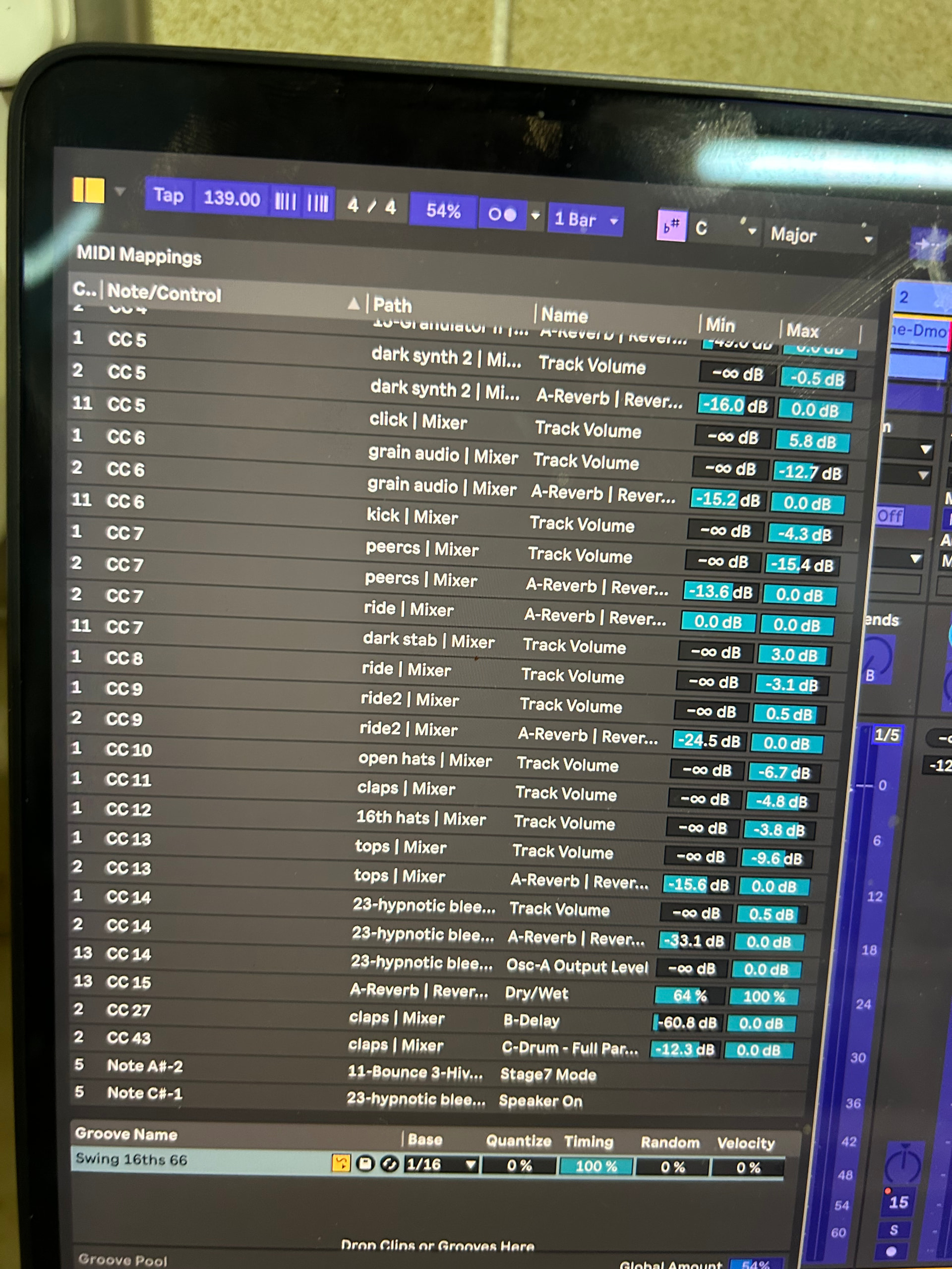

I have the Live 15 and the Side 8 Custom, both controllers Arte working fantastically. I do have an issue tho, in my live projects when it comes to arranging the track I play live and record it all in on the controllers. I haver my send encoders in Live at different settings but don’t want to automate the encoder and loose my original start point that I set on the encoder in live or same situation with the mixer track levels id like to get them all to a level I’m happy with and then automate from that pint without the level getting any higher than the set point.
So basically I want to be able to set the minimum and maximum middi mapping settings for each return pot and fader - the only way I have been able to do this is to midi map inside Ableton and assign the encoder on the live 15 or side 8 to what ever encoder or fader I want-
it kind of works but if I assign anything on the side 8 for example track 7 fader it then moves the track 7 fader on the live 15 as well……any help would be great!
