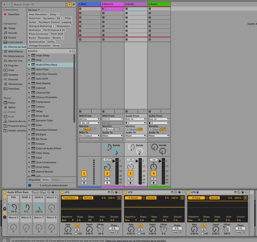

Hello @manuel,
Adding to what @ale said, for the pan and sends of a track, there is a workaround that I just tested, and it works. You can do it with the current state of the script.
It works by adding some M4L LFO devices in each track, within a Rack. Then mapping them to the track Pan and Sends parameters, and changing the value with the Offset parameter of each LFO, which needs to be mapped to a macro.
This way, you can just use the “selected track” device controls to modulate these LFO’s, therefore controlling the mixer parameters you need.
Let us know if you manage to achieve your plans with any of these suggestions.
Cheers!
Hi, I finally got time to test this and this works. Nice, thank you for the note. The only issue is that if you have multiple devices in a track this only works for the selected device. The Audio Rack with the LFOs need to be the selected device. For example I have the 3 encoders set to Channel 11 CC 0,1,2. Whatever device is now selected, it will be controlled by those encoders.
If you want your encoders to permanently control your Audio Rack with the LFOs regardless of what you click on in Ableton, you need to map them to a specific track instead. The script supports dedicating controls for up to 8 specific tracks and 8 devices per track.
To do this, change the MIDI channel of your encoders depending on which track your Audio Rack is located:
  • If it’s on Track 1 (Device 1): Use MIDI Channel 3 with CC 0, 1, and 2.
  • If it’s on Track 2 (Device 1): Use MIDI Channel 4 with CC 0, 1, and 2.
  • (This pattern continues up to Track 8, which uses MIDI Channel 10).
Also, remember to account for the device’s position in your chain. If your Audio Rack is the second device on Track 1, you will still use Channel 3, but the values will change to CC 8, 9, and 10.
Important:** Open your Map.py file and make sure the variable TRACK_STRIP_PARAMETER_CONTROLS_ENABLED is set to True so the script listens for these specific track commands.
