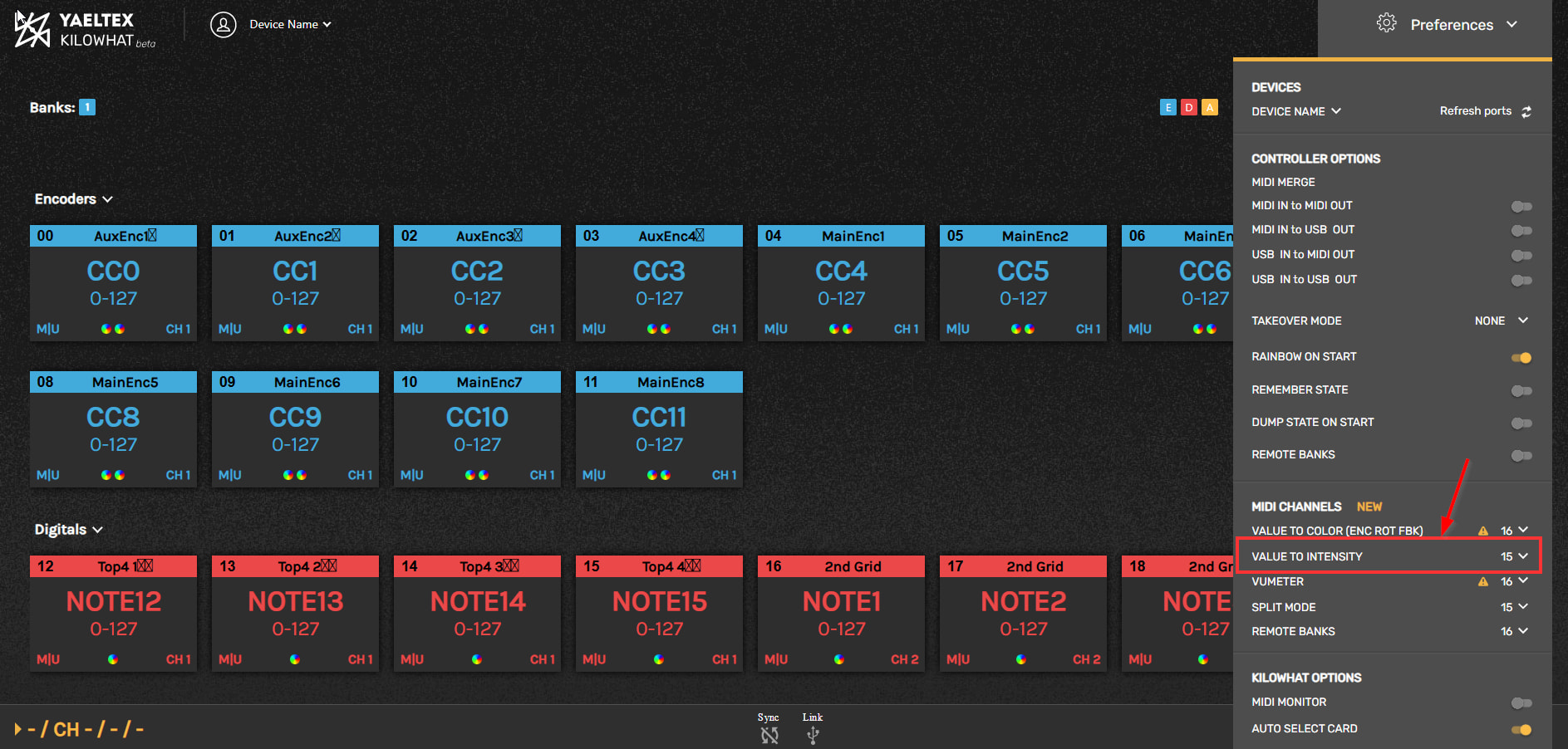

  1. Assign the Channel: Go to the General Preferences in Kilowhat (under Controller Options > MIDI Channels) and set a specific MIDI channel for the “Value to intensity” feature.*

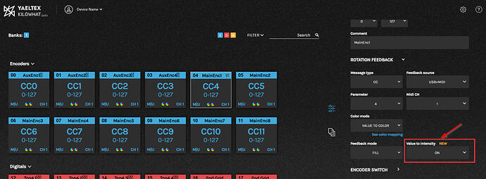

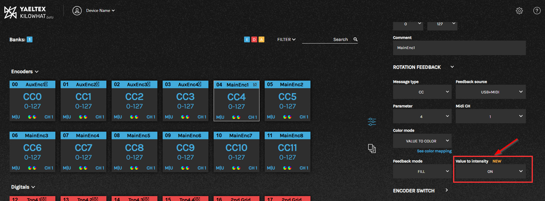

  2. Enable the feature on the specific encoder’s rotary feedback section
  3. Hit SEND TO DEVICE to upload the new configuration.

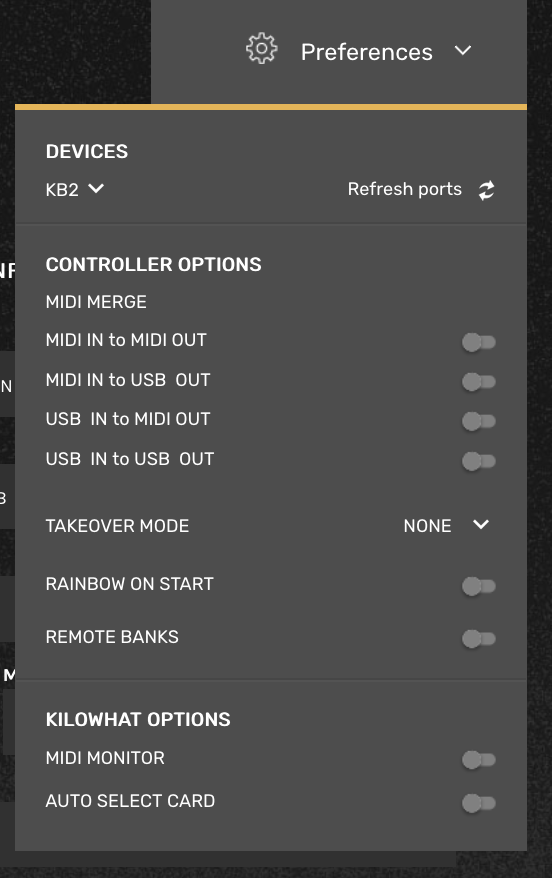

I’m running this firmware:
this is what my General Preferences look like:
