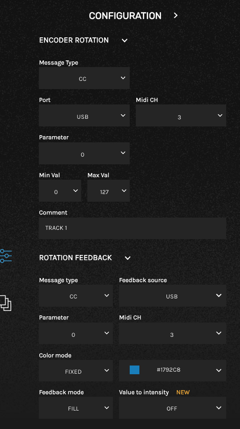

Encoder Mapping To Control Device 1 control on each track:
For the above i have the correct mapping for each of the tracks. I can provide screenshots if needed.

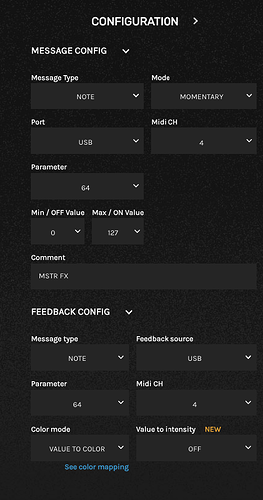

Button Mapping To Turn ON OFF Selected Track Device 1:
I already tried changing the mode to toggle as a test but it didnt work!

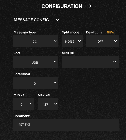

Encoder Mapping To Control Selected Track Parameters: (In this case parameter 1)
My controller is called NYRA. Help would be very appreciated here. All other functions are working properly.
