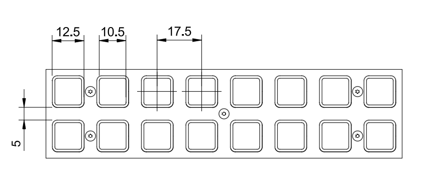

Could anyone tell me the exact space (in mm) between MINI RGB buttons? Maybe also tell me the exact mm size of the Mini RGB Buttons themselves?

Hey @clint.goss !
The distance between the center of all mini element is 17,5 mm.
The distance between the center of all normal elements is 35 mm.

Thanks for the precision … MUCH appreciated!!
