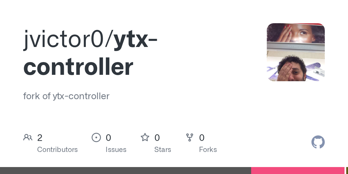

Here are my changes to the controller
My controller works great, but I don’t have enough context to understand if the code is “correct”, much less “stylistically correct”. Theres still a circular buffer overrun hiding somewhere, but now the updates are fast enough that I can’t hit it with my actual instrument.

Ok I fixed the checksums and uploaded a patch to my github. Works great now: heres what it looks like:
