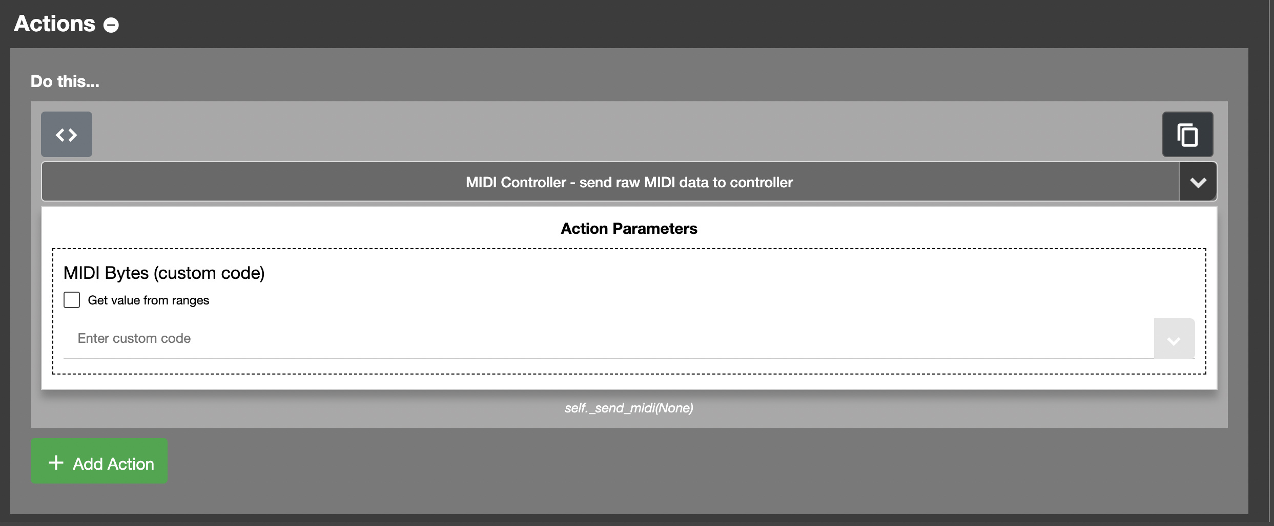

I see that by default the MIDI channel for Value to Intensity is 15 - so perhaps I probably need to specify this in the code. There is an option for this ‘send raw MIDI data to Controller’ (see screen shot) Although unfortunately I have no idea what information/string I would have to send.

In CSS there is an option to input custom code so I can define the input for the MIDI data. As stock it is shown like this:

“Send RAW MIDI data” might help if you can combine it with the custom parameter you want to send.
Raw MIDI data consists of three bytes in hexadecimal format:
Byte 1: Command
For Note ON this command is 0x90 for channel 1, 0x91 for channel 2, 0x92 for channel 3 and so on.
Here you have to use the channel you configured on Kilowhat - 1, in hexa.
For example, for channel 15 the correct byte would be 0x9E.
Note OFF is similar but 0x80, 0x81, …
Control Change command ix 0xB0, 0xB1 and so on for different channels.
Byte 2: Note # or Controller #
This is the note number from 0x00 to 0x7F (0 to 127)
Byte 3: Velocity or Value
This would be the actual parameter you want to send, again, from 0 to 127 in hexadecimal.
If you find a way to send this raw midi data, the value to intensity feature should work.
Let me know if this helped and if you have any further doubts!

There is an option is in Remotify for ‘Send RAW MIDI Data’ but the problem with this as far as I can tell is this restricts me to a static value. As I understand it the 3rd Byte in the string can only be input as a static value and will not give me the flashing Feedback I’m looking for.
