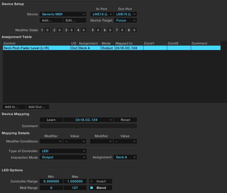

1. The “Spot” vs “Fill”. When you configure an encoder as a Vumeter CC, the behavior you described—seeing only a “spot value”—is actually the correct hardware behavior. In this mode, the encoder ring uses a single spot (usually a white dot) to display the current physical position of your fader or volume knob. The “fill” feedback is reserved exclusively for the incoming audio VU data. The reason you are losing the fill and only seeing the spot is simply because the controller is not receiving the actual VU audio levels from either Traktor or Ableton on your new channel.
2. Fixing the Traktor VU Routing. To get the fill working in Traktor, you must ensure that Traktor is actually broadcasting the audio level out to the controller.
  • In Traktor’s Controller Manager, you need to add an Output mapping for the Deck Level.
  • Route this output to your controller.
  • Crucial Step: Set the MIDI Channel for this output to Channel 6 (matching your new Global VUMETER channel in Kilowhat), and set the CC number to exactly match the CC parameter assigned to that specific volume encoder.
This is how it should look—in this case, using channel 16.
